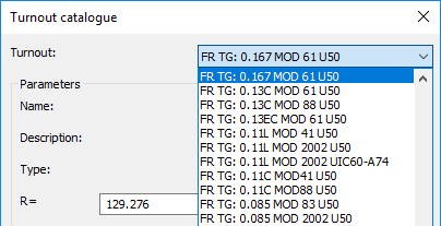

When you are creating a rail platform edge, you can select France_Metric.json or Germany_Metric.json as the design rule file to use. For more information, see Create/Edit Platform Edge Dialogue Box.

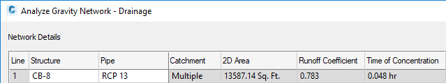

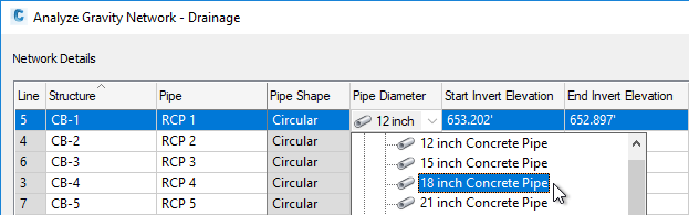

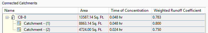

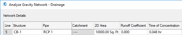

By setting up and applying the mapping for these parts, the parameter values will be available within the Analyse Gravity Network command by default.
For more information, see To Map Drainage Structure Parameters for Gravity Network Analysis.

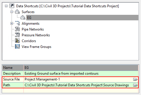

After selecting the alternate Source File or Path, a dialog box is displayed which you can use to update the shortcuts. Drawing objects that reference the original path will be updated to reference the alternate path.
