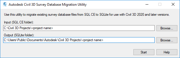

Survey Database Format Change
The survey database format has been updated from Microsoft SQL Server Compact (SQL CE) format to SQLite. To use existing survey databases with Autodesk Civil 3D 2020, they must be converted to SQLite.
Use the Survey Database Migration Utility to convert survey databases from SQL CE to SQLite.
The Survey Database Migration Utility is a separate download available at https://knowledge.autodesk.com/support/autocad-civil-3d/downloads.
For more information about using this utility, see To Update a Survey Database.
Important: Migrated databases are not compatible with earlier releases of Autodesk Civil 3D. However, the SQL CE (.sdbx) databases are not overwritten or deleted during the migration process and can be used in earlier releases of Autodesk Civil 3D.
