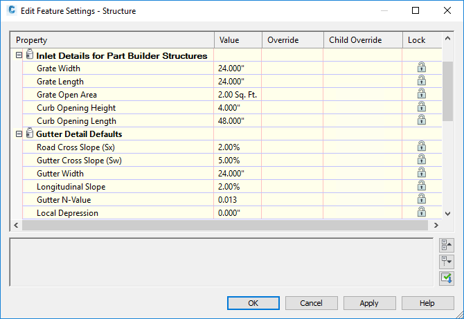

- Use new structure feature settings to specify default values that can be used by the Analyse Gravity Network command.
For more information, see About Analysing and Size a Gravity Pipe Network and Edit Feature Settings – Structure Dialog Box.

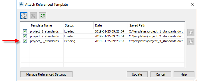

- When you attach an additional reference template to a drawing, it's now added to the bottom of the list of templates and customised settings that have already been specified for the previously-attached templates are preserved.
For more information, see To Work With Reference Templates.

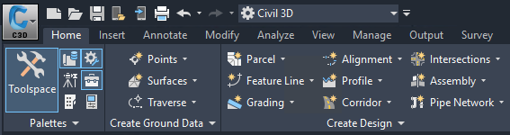

- The Dark colour scheme and the application ribbon icons have been updated.
- The Dark colour scheme that controls the appearance of the application window, ribbon and other user interface elements has been updated with new colours.
- Ribbon icons for both the Light and Dark colour schemes have been updated for style and clarity, optimised to work with the background colours and updated to scale with high-resolution monitors.
