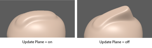

Whole Stroke is only available when Update Plane is on.
