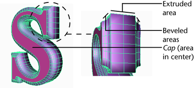

As you edit the Bevel Plus options, refer to the following figure, showing the parts of the surface created by Bevel Plus:

Turns beveling on or off at either end of the resulting surface. At Start controls the portion closest to the curve and At End controls the portion furthest from the curve.
Specifies the width of the beveled area as viewed from the front of the resulting surface.
Specifies the depth of the beveled area as viewed from the top or side of the resulting surface.
Specifies the distance of the extruded portion of the geometry, excluding the beveled areas.

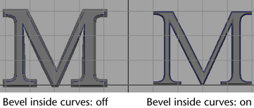

Turns on beveling inside the curve rather than outside it. Turning this option on gives you greater control over the overall size of the beveled surface since you are guaranteed the resulting surface will be no larger than the original curve.

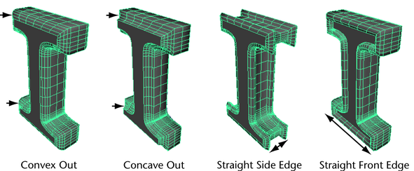

The bevel style controls the overall look of the beveled surface. For example, Straight Out creates a straight beveled edge extending outward from the original curve.
You can switch between styles and compare the results by accessing the outerStyleCurve or innerStyleCurve attribute from the Attribute Editor or Channel Box.
The following figure illustrates some of the terms used in the bevel style names:
The Outer and Inner style are for letters or art that have an outer curve and an inner curve, such as the letter O. By default, they share the same bevel style, but you can make them different by turning off the Same As Outer Style option.
