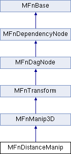

C++ API Reference
DistanceManip function set. More...
#include <MFnDistanceManip.h>
+ Inheritance diagram for MFnDistanceManip:
