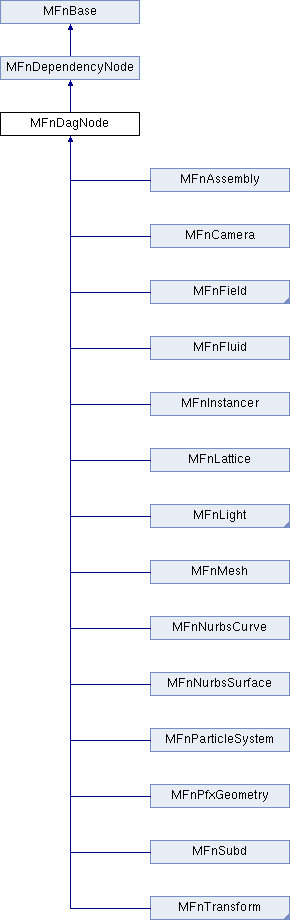

DAG Node Function Set. More...
#include <MFnDagNode.h>
+ Inheritance diagram for MFnDagNode:
