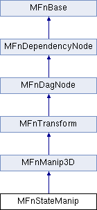

+ Inheritance diagram for MFnStateManip:
