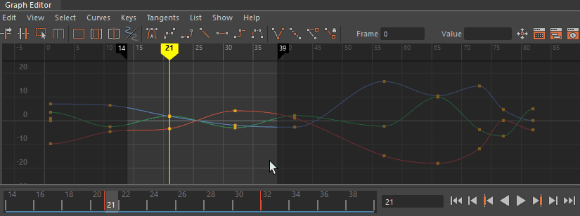

Show Play Range Shades
Turn this on to display the Play Range Shades in the modern Graph Editor. (The Play Range Shades do not appear in the Classic Graph Editor.)
Tip: You can change the color and opacity of the Graph Editor Play Range Shade in the Color Settings . (There are separate sections for the Graph Editor and Classic Graph Editor colors.) See also Graph Editor Colors.
See Graph Editor Play Range Shades in the Graph Editor Graph view topic for more.
Lock Play Range Shades
Turn this on so the Graph Editor Play Range Shades cannot be dragged. This prevents you from accidentally moving the Play Range Shades when moving the Current Time Marker to scrub the time. You can still change the Playback range with the Range slider when this setting is active, but you cannot drag the Play Range Shades in the Graph Editor.
This setting is off by default.

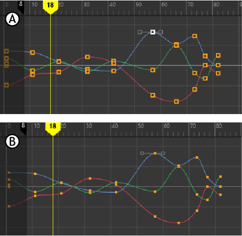

Key View
Note: This option appears only in the Modern Graph Editor View menu.
Lets you switch between the default Detailed Key View (A) and Simplified Key View (B), which looks similar to the Classic Graph Editor display.
Key View: A Detailed, and B simplified
Detailed key view
The Modern Graph Editor default view, Detailed key view gives you visual cues about keys and tangents, such as showing filled or hollow keys that show whether a key has been edited or is automatic or identifying the type of curve. This feedback provides a quick way to identify the state of the animation you're working with.
Simplified key view
Simplified key view contains less visual information on the keys and is the same as the key and tangent display in the Classic Graph Editor.
If you want to simplify your view to show only the key you're working on, or the curves without keys, see Keys, above, and change the setting to Active.

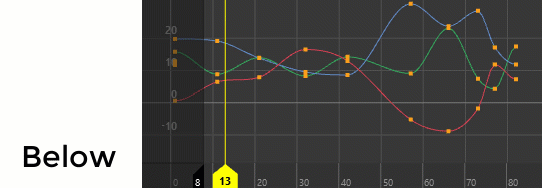

Time ruler Placement
Lets you change the position of the Graph Editor Time ruler so that you can align it with the Time Slider. Choose between Top or Bottom.
