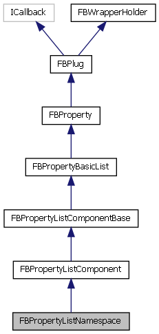

List: Namespace More...
#include <fbnamespace.h>
Public Member Functions | |
| FBNamespace * | operator[] (int pIndex) |
| Get the Namespace object at pIndex. More... | |

List: Namespace
Definition at line 62 of file fbnamespace.h.
| FBNamespace* operator[] | ( | int | pIndex | ) |
| pIndex | Index of Namespace to get. |
