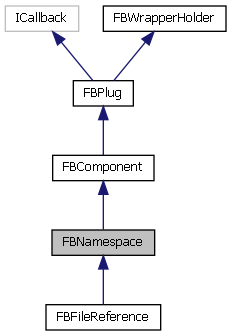

Objects Containing class. More...
#include <fbnamespace.h>
Public Member Functions | |
| FBNamespace (const char *pSingleLevelNamespace, FBNamespace *pParentNSObj) | |
| Constructor. More... | |
| int | GetContentCount () const |
| Get the namespace content objects count (Not Recursive). More... | |
| FBComponent * | GetContent (int pIndex) const |
| Get the namespace content object count (Not Recursive). More... | |
| void | GetContentList (FBComponentList &pContentList, FBPlugModificationFlag pModificationFlags=kFBPlugAllContent, bool pRecursive=true, int pTypeInfo=FBPlug::TypeInfo, bool pExactTypeMatch=false) |
| Get List of the namespace content. More... | |
