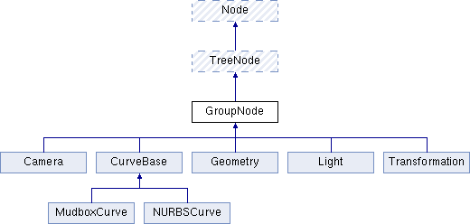

This is the base class for all nodes that are transformable objects in the Mudbox scene.
For example, cameras, lights, and geometry are all derived from GroupNode. In the Mudbox scene hierarchy, each GroupNode is the child of a Transformation node, which provides its positional and size information.
Definition at line 22 of file transformation.h.
+ Inheritance diagram for GroupNode:
