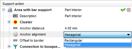

  6. Modify the settings for selected support actions as needed.
    Modifying a support action
