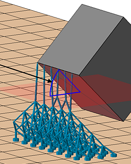

Cluster Detection
A cluster is an area formed by contiguous triangles that are determined to require support by a set of parameters. You can adjust cluster detection individually for each area-based support action.
Note: You should specify the angles first. All other settings affect criteria to exclude clusters that do not match any of these criteria.
Parameter Description Notes
Minimal, Maximal area
The size of a detected cluster's area must be fully within the range specified here, or it is disregarded for the respective support action.
Critical angle
Areas of down-facing triangles angled at least this much away from the horizontal, highlighted in red, must be, and at minimum are, supported.
Adjust this to meet your machine's and material's requirements.
0-90 °
Noncritical angle
Areas of down-facing triangles angled at least this much away from the horizontal, highlighted in yellow, may be supported if they border on enough critically or non-critically angled triangles.
Adjust this to smooth the support contour or to merge small clusters of critical angle.
0-90 °

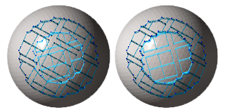

Duplicate support
With this option you can control whether triangles of a cluster should get supported with the respective action even when a previous action in the script has already applied support to the same triangles. By overlapping supported areas like that, you can create stepped support density that is stronger where the downskin's angle is particularly shallow, for example.
This sphere was supported with a script that included two actions with different values for cluster detection each. The smaller cluster was determined first. Left: Duplicate support tolerated. Right: Avoided.
Avoid, Tolerate

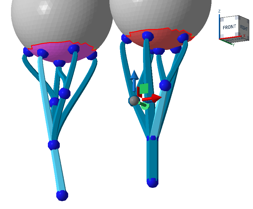

Side branching
  • The entire bouquet can be shifted at once by moving its singular bottom termination point, and all attached bars adjust "organically".
  • Anchors where bars terminate on other bars can only be moved along those bars. This makes editing less destructive, but also somewhat limited.
  • All bars have the same diameter regardless how many or few bars terminate in them. This can limit their use where actual load-bearing is a determining factor.
Split branching
  • When bars split (or merge), the cross section area is distributed (or combined) accordingly, too.
  • Anchors where splits happen can be moved individually in all directions, and the segments between anchors are individual bar entities. This allows more freedom but at the same time requires more attention to positioning.
  • Since anchors are independent, they do not move proportionately. All selected anchors move by the same amount and in the same direction.
Side branching (left) and split branching (right). Note how the selected one on the left goes all the way from the part surface to the bottom, and how other beams "sprout" from it, whereas on the right, the branches split evenly.

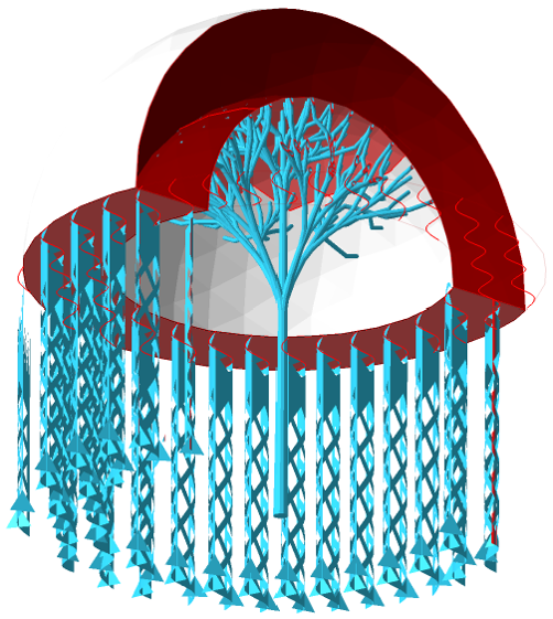

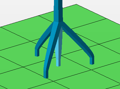

Root system
When active, the bottom of the bars are multiplied to form a tree-root-like structure that reinforces the adherence of individual bars.
Number of legs
The count of legs includes the center one.
Height
At this height above the platform or the bottom part surface, measured along the center leg, the side legs merge with the main bar.
Diameter
The side bars terminate at a circular contour of this diameter parallel to the build platform. If the bars meet a suitable surface before or beyond this imaginary circle, such as when they terminate an uneven part surface, the bards are shortened or extended appropriately to maintain the side bar angle.
