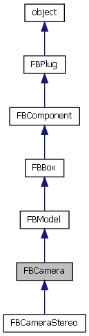

Creates custom cameras and manages system cameras. More...

Public Member Functions inherited from FBModel | |

Public Member Functions inherited from FBBox | |

Public Member Functions inherited from FBComponent | |
