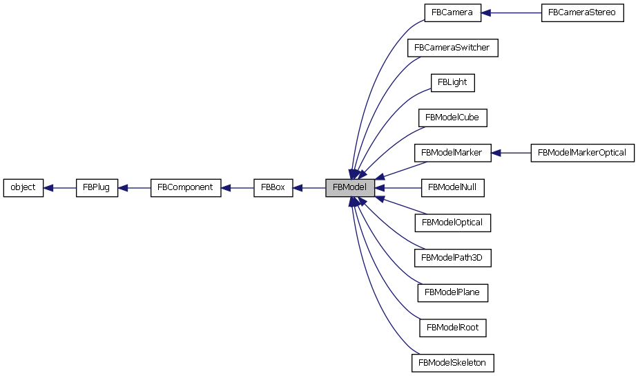

Model class. More...
Inheritance diagram for FBModel:
