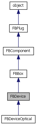

Base Device class.
Cannot be instantiated from Python.
See samples: StartDevice.py, StopDevice.py.
Read Write Property: Set this to how many times a device is to be evaluated in one second. There is no theoretical maximum value but practically you should consider scene complexity, system resources, network speed, etc. If set to 0: the device is evaluated on the sync signal. When the sync occurs; the device is scheduled to be evaluated. If you do not set, the sampling period is based on the internal variable from the [Sync] section of the .Application.txt file (NTSC, PAL, CINEMA).
