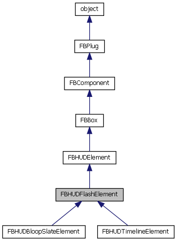

Heads Up display.
Flash HUD element. Display a flash (swf) file rendered on the HUD.
See sample: HUDElements.py.
| FBHUDFlashElement | ( | str | pName | ) |
Constructor.
| pName | Name of new HUD flash element. |
| str FilePath |
Read Write Property: Path to load the swf file from
