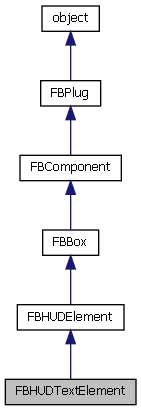

Heads Up display. More...

Public Member Functions inherited from FBBox | |

Public Member Functions inherited from FBComponent | |

Public Attributes inherited from FBHUDElement | |

Public Attributes inherited from FBBox | |

Public Attributes inherited from FBComponent | |

Public Attributes inherited from FBPlug | |

Heads Up display.
Text element. Render text with a background rectangle to the HUD.
See samples: HUDElements.py, HUDTextElement.py, HUD.py.
