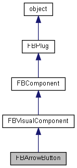

Creates a button which opens a layout to display content. More...
When pushed a layout to display content (another control or a layout) is opened. A small arrow to the left of the button title, shows whether the content is shown (points down) or not (points to the title).
See samples: ArrowButton.py, FBCamera.py.
| FBArrowButton | ( | ) |
Constructor.
| SetContent | ( | str | pTitle, |
| FBVisualComponent | pContent, | ||
| int | pContentWidth, | ||
| int | pContentHeight | ||
Sets the content to be hidden/shown by button.
The FBArrowButton must already have been added to a layout before calling this method.
| pTitle | Title of the content managed by the FBArrowButton |
| pContent | Content that the FBArrowButton displays or hides |
| pContentWidth | Width of the content |
| pContentHeight | Height of the content |
