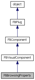

Property browsing.
Constructor.
| AddObject | ( | FBPlug | pObject | ) |
Add an object whose properties will be displayed.
| pObject | Object whose properties will be displayed in the property brwoser. |
Return the object at the specified index.
| pIndex | Index of the object to get. |
| int ObjectGetCount | ( | ) |
Get the number of object displayed in the property browser.
| RemoveObject | ( | FBPlug | pObject | ) |
Remove an object from the property browser.
| pObject | Object to remove. |
