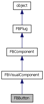

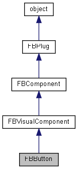

Public Member Functions | |
| FBButton () | |

Public Member Functions inherited from FBVisualComponent | |

Public Member Functions inherited from FBComponent | |

Public Attributes inherited from FBPlug | |
