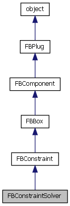

Inheritance diagram for FBConstraintSolver:
