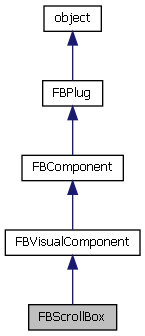

Scroll Box
This class provides a layout that will be automatically managed with a scrollbar according to the specified width and height.
More...
