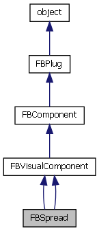

Base spreadsheet class. More...
See samples: ActionScriptMgr.py, KeyboardMapper.py, Spread.py.
