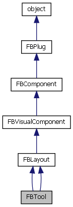

Tool class. More...
Public Member Functions | |
| FBTool (str pName=None) | |
| Constructor. More... | |
| FBTool (str pName, bool pRegisterTool) | |
| Constructor used when creating tools not in the Tools menu of Motion Builder. More... | |

Tool class.
