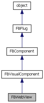

Web viewer. More...
Public Member Functions | |
| FBWebView () | |
| Constructor. More... | |
