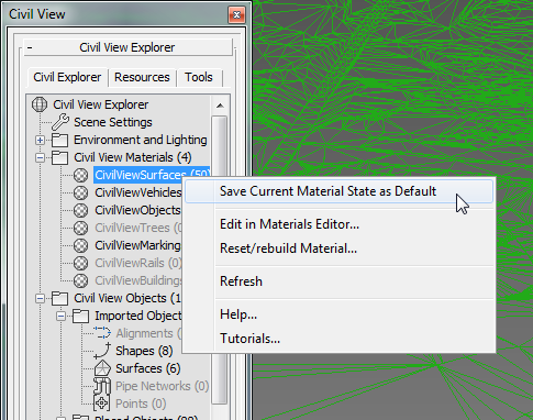

Overwrite the automatically generated CivilViewSurfaces material in the civilviewsurfaces.mat file with a custom Multi/Sub-Object material of the same name.
An easy way to achieve this is to customize the material to your personal preferences in 3ds Max, then right-click the CivilViewSurfaces material in the Civil View Explorer panel and choose Save Current Material State As Default.
