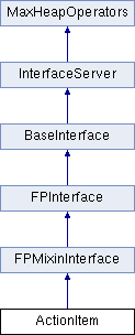

Represents an operation contained in an ActionTabls.
ActionItem is an abstract class with operations to support various UI operations. The system provides a default implementation of this class that works when the table is built with the ActionTable::BuildActionTable() method. However, developers may want to specialize this class for more special-purpose applications. For example, MAXScript does this to export macroScripts to an ActionTable. Methods that are marked as internal should not be used.
- Version
- 4.0
- See also
- Class ActionTable, Class ActionCallback, Structure ActionDescription, Class ActionContext, Class IActionManager, Class DynamicMenu, Class DynamicMenuCallback, Class MAXIcon, Class Interface, class FPMixinInterface
