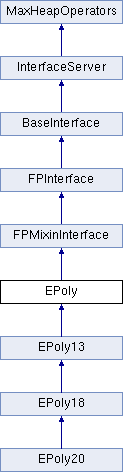

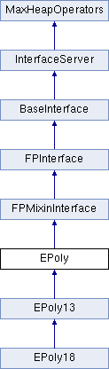

The EPoly class is the main interface to the Editable Poly Object. This class is a virtual class with no data members. More details can be found in the SDK samples under /MAXSDK/SAMPLES/MESH/EDITABLEPOLY.
+ Inheritance diagram for EPoly:
