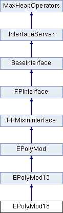

 Inheritance diagram for EPolyMod18:
 Inheritance diagram for EPolyMod18:| Public Member Functions | |
