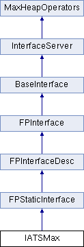

Interface to Asset Tracking System.
This interface gives access to the Asset Tracking System. This includes control over the Asset Tracking dialog, support dialogs, and version control system integration. It also provides access to the Asset Repathing UI functionality and file dependency information. The version control system related methods (such as checkin, checkout, etc.) incorporate the common dialogs used for all providers. For lower level access to providers use the IATSProvider interface.
- See also
- IATSProvider, ATSFileList
