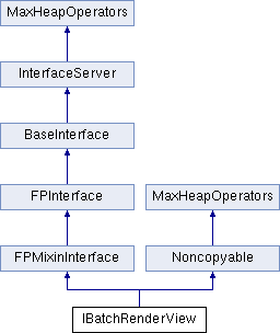

 Inheritance diagram for IBatchRenderView:
 Inheritance diagram for IBatchRenderView:| Public Types | |
