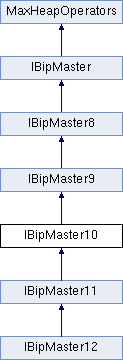

#include <Biped10Api.h>
Interface into the biped master controller for Max 10.
This contains functions supporting new biped features in Max 10, in particular Xtras.
 Inheritance diagram for IBipMaster10:
 Inheritance diagram for IBipMaster10:| Public Types | |
| enum | { kRETARGET_NONE =1, kRETARGET_HEIGHT =2, kRETARGET_LIMB =3 } |
| enum | { kSAVE_NONE =0, kSAVE_AUTOMATIC =1, kSAVE_SPECIFIED =2 } |
| enum | { kLOAD_NONE =0, kLOAD_ALL =1, kLOAD_SPECIFIED =2 } |
| Public Member Functions | |
| Xtras | |
| Xtras are extra FK appendages on a biped. You can have a maximum of MAXXTRAS Xtras. The following functions may be used to create, delete, and modify biped Xtras, and to paste Xtra copies. | |
| virtual INode * | CreateXtra (int nlinks, const MCHAR *name)=0 |
| Creates an Xtra with the specified number of links and base name.  More... | |
| virtual INode * | CreateXtraOpposite (INode &xtra, bool doChildren)=0 |
