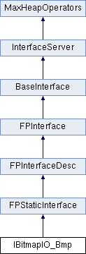

#include <istdplug.h>
This class represents the interface for the Bitmap IO BMP format.
The interfaceID is defined as BMPIO_INTERFACE. Through C++ you can access the interface the following way:
