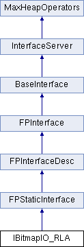

The IBitmapIO_RLA class expands upon the previous IBitmapIO classes.
- See also
- Class IBitmapIO
- Description:
- The IBitmapIO_RLA class expands upon the previous IBitmapIO classes for .bmp, .jpeg, .png and .tga. Like these others, it is a static interface; the code to fetch the interface is given below. The interface does not directly change the configuration of an existing BitmapIO. Instead, these methods set the default values, which will be used the next time an RLA or RPF file is saved. The defaults will also appear in the bitmap configuration dialog if the user saves an RLA or RPF file.
- Usage:
- Both RLA and RPF have the same interface class, IBitmapIO_RLA, but some of the methods of this class are RPF-specific, giving undefined behavior if used on an RLA instance of the class.
