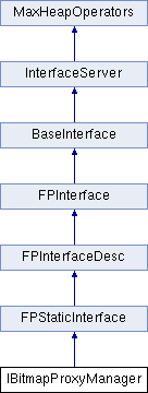

 Inheritance diagram for IBitmapProxyManager:
 Inheritance diagram for IBitmapProxyManager:| Public Types | |
