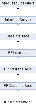

Interface to the brush preset manager.
The manager is a singleton object implemented by the system. It maintains the list of contexts and presets. It communicates with the contexts to track which is active, and when a context is updated. It tracks which preset is active in order to store parameters into the preset when contexts are updated. It has functionality to read and write brush preset files. Finally, the brush preset manager provides a maxscript interface to activate and deactivate presets.
