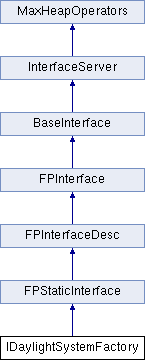

Factory for daylight system objects.
The type of Sun and Sky components are specified by the current Market Default. Use this interface to create instances of the daylight system. Client code can get to this interface as follows:
 This interface is implemented by 3ds Max.
