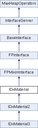

#include <IDxMaterial.h>
An interface class to manage access to various parameters used by DirectX effects.
