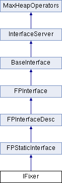

Interface for perfoming workbench fixer functions.
This class peforms workbench functions related to the fixing of fcurves. Fixing is done after analysis is done and works by fixing the analysis detection locations.
- See also
- IAnalysis You get this interface by calling GetCOREInterface(FIXER_INTERFACE)
IWorkbench
|  | DECLARE_DESCRIPTOR (IFixer) |
| virtual void | DoAngSmoothing (Tab< INode * > &nodes, int width, float damping) |
|  | Perform Angular Smooth fixing on the passed in biped nodes.  More...
| virtual void | DoAngBlurring (Tab< INode * > &nodes, int width, float damping) |
|  | Perform Angular Blur fixing on the passed in biped nodes.  More...
| virtual void | DoAdvAngSmoothing (Tab< INode * > &nodes, int width, float damping) |
|  | Perform Advanced Angular Smooth fixing on the passed in biped nodes.  More...
| virtual void | DoPosSmoothing (Tab< INode * > &nodes, int width, float damping) |
|  | Perform Position Smooth fixing on the passed in biped nodes.  More...
| virtual void | DoPosBlurring (Tab< INode * > &nodes, int width, float damping) |
|  | Perform Position Blur fixing on the passed in biped nodes.  More...
| virtual void | DoRemoveKeys (Tab< INode * > &nodes, int intervalWidth, BOOL deleteKeys) |
|  | Perform Remove Key fixing on the passed in biped nodes.  More...
| virtual void | DoKneeWobbleFix (Tab< INode * > &nodes, float frameThreshold, float fluctuationThreshold) |
|  | Perform Knee Wobble Fix.  More...
| virtual void | DoKneeExtensionFix (Tab< INode * > &nodes, float kneeAngle) |
|  | Perform Knee Extension Fix.  More...
