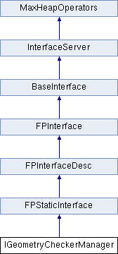

The interface to the geometry checker manager.
This manager is responsible for registering, activitating and displaying the results of the geometry checkers. You get this interface by calling GetIGeometryCheckerManager()
