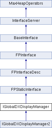

This interface provides the user control over how the viewport shaders are displayed in the viewport.
This interface provides the user control over how the viewport shaders are displayed in the viewport. Control is provided to turn of the display totally and use the original material in the viewport, or to display the shader only on the selected node. The new material options for viewport shaders use this interface to control the system.
Developers can control this themselves using this interface, you simply have to use GetGlobalDXDisplayManager() to get to the actual interface.
