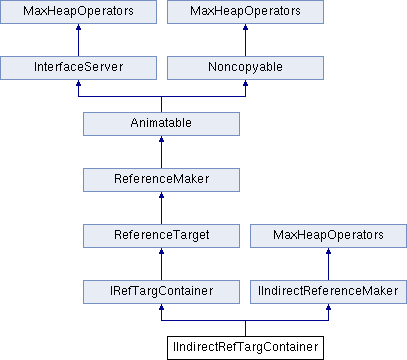

| virtual SClass_ID | SuperClassID () |
|  | Retrieves a constant representing the type of the plugin.  More...
| virtual Class_ID | ClassID () |
|  | Retrieves a constant that uniquely identifies the plugin class.  More...
| virtual CoreExport void * | GetInterface (DWORD in_interfaceID) |
| virtual CoreExport BaseInterface * | GetInterface (Interface_ID id) |
|  | Inherited from Animatable.  More...
| virtual int | GetNumItems () const  =0 |
|  | Returns the number of items in the container.  More...
| virtual ReferenceTarget * | GetItem (int i) const  =0 |
|  | Returns the i-th item, NULL if i is out of range.  More...
| virtual int | AppendItem (ReferenceTarget *ref)=0 |
|  | Adds an item at the end of the container.  More...
| virtual void | SetItem (int i, ReferenceTarget *ref)=0 |
|  | Sets the value of the i-th container item.  More...
| virtual int | InsertItem (int i, ReferenceTarget *ref)=0 |
|  | Inserts specified item at i-th place into the container.  More...
| virtual void | RemoveItem (int i)=0 |
|  | Removes the i-th item from the container.  More...
| virtual int | FindFirstItem (ReferenceTarget *refTargToFind) const  =0 |
|  | Finds the first occurrence of a given reference target in the container.  More...
| virtual bool | GetHoldAsWeakReferences () const  =0 |
|  | Returns whether the references are held as weak references.  More...
| virtual void | SetHoldAsWeakReferences (bool holdAsWeakReferences)=0 |
|  | Sets whether the references are held as weak references.  More...
| virtual int | GetChangedRefTargetIndex ()=0 |
|  | When a NotifyRefChanged is received from an IRefContainer, this method can be called to retrieve the index of the item that generated the notification.  More...
| virtual ReferenceTarget * | GetChangedRefTarget ()=0 |
|  | When a NotifyRefChanged is received from an IRefContainer, this method can be called to retrieve the item that generated the notification.  More...
| virtual CoreExport void | GetClassName (MSTR &s) |
|  | Retrieves the (localizable) name of the plugin class.  More...
| virtual BOOL | IsRefTarget () |
|  | Checks if this is a ReferenceTarget.  More...
| CoreExport RefResult | TestForLoop (const Interval &refInterval, RefMakerHandle hmaker) |
|  | Tests for a cyclical reference.  More...
| CoreExport BOOL | HasDependents () |
|  | Checks if a ReferenceTarget has references.  More...
| CoreExport BOOL | HasRealDependents () |
|  | Checks if this has Real (Strong) Dependents.  More...
| void | BeginDependencyTest () |
|  | Starts Dependency Test.  More...
| BOOL | EndDependencyTest () |
|  | Ends Dependency Test.  More...
| virtual void | RefAdded (RefMakerHandle rm) |
|  | Called after a reference is made to a target.  More...
| virtual void | RefAddedUndoRedo (RefMakerHandle rm) |
|  | Called after a reference is made to a target because of undo or redo.  More...
| virtual void | RefDeleted () |
|  | Called after a references to this is deleted.  More...
| virtual void | RefDeletedUndoRedo () |
|  | Called after a references to this is deleted because of undo or redo.  More...
| CoreExport RefResult | DeleteAllRefsToMe () |
|  | Deletes all references to this ReferenceTarget.  More...
| CoreExport RefResult | TransferReferences (RefTargetHandle oldTarget, BOOL delOld=FALSE) |
|  | Transfers all the references from oldTarget to this.  More...
| CoreExport int | DoEnumDependents (DependentEnumProc *dep) |
|  | Begins an enumeration that searches back in the dependency network.  More...
| virtual CoreExport RefTargetHandle | Clone (RemapDir &remap) |
|  | This method is used by 3ds Max to clone an object.  More...
| virtual CoreExport void | BaseClone (ReferenceTarget *from, ReferenceTarget *to, RemapDir &remap) |
|  | This method copies base class data from an object to its clone.  More...
| virtual CoreExport RefResult | NotifyDependents (const Interval &changeInt, PartID partID, RefMessage message, SClass_ID sclass=NOTIFY_ALL, BOOL propagate=TRUE, RefTargetHandle hTarg=NULL, NotifyDependentsOption notifyDependentsOption=REFNOTIFY_ALLOW_OPTIMIZATIONS) |
|  | Notify all dependent RefMakers concerned with the message.  More...
| void | FlagDependents (TimeValue t, PartID which=PART_PUT_IN_FG) |
|  | This sends the REFMSG_FLAGDEPENDENTS message up the pipeline.  More...
| virtual void | NotifyForeground (TimeValue t) |
|  | This method is called to flag dependents into the FG.  More...
| virtual void | NotifyTarget (int message, ReferenceMaker *hMaker) |
|  | Sends messages to ReferenceTargets.  More...
| virtual CoreExport void * | GetInterface (ULONG id) |
| CoreExport | ReferenceTarget () |
|  | Constructor.  More...
| virtual CoreExport RefResult | AutoDelete () |
|  | Deletes the object when it has no more real dependents.  More...
| CoreExport RefResult | MaybeAutoDelete () |
| CoreExport RefResult | ReplaceReference (int which, RefTargetHandle newtarg, BOOL delOld=TRUE) |
|  | Used when cloning reference makers.  More...
| CoreExport RefResult | DeleteAllRefsFromMe () |
|  | Deletes all references from this ReferenceMaker.  More...
| CoreExport RefResult | DeleteAllRefs () |
|  | Deletes all references both to and from this item.  More...
| CoreExport RefResult | DeleteReference (int i) |
|  | Deletes the specified reference.  More...
| virtual BOOL | CanTransferReference (int i) |
|  | Tells whether this reference can be transfered.  More...
| CoreExport ReferenceSaveManager & | GetReferenceSaveManager () |
|  | Access the ReferenceSaveManager of this ReferenceMaker.  More...
| virtual CoreExport IOResult | Save (ISave *isave) |
|  | Called for saving data.  More...
| virtual CoreExport IOResult | Load (ILoad *iload) |
|  | Called for loading data.  More...
| virtual int | RemapRefOnLoad (int iref) |
|  | Used to load old files with references.  More...
| virtual CoreExport void | RescaleWorldUnits (float f) |
|  | Rescale size of all world units in reference hierarchy.  More...
| virtual CoreExport void | EnumAuxFiles (AssetEnumCallback &assetEnum, DWORD flags) |
|  | Enumerate auxiliary files (e.g. bitmaps)  More...
| virtual CoreExport void | SaveEnum (SaveEnumProc &sep, BOOL isNodeCall=0) |
|  | The default save enumeration.  More...
| virtual CoreExport bool | SpecifySaveReferences (ReferenceSaveManager &referenceSaveManager) |
|  | Used to specify reference slot remapping during scene file save.  More...
| CoreExport bool | EnumRefHierarchy (RefEnumProc &proc, bool includeCustAttribs=true, bool includeIndirectRefs=true, bool includeNonPersistentRefs=true, bool preventDuplicatesViaFlag=true) |
|  | This method provides a general purpose reference enumerator.  More...
| CoreExport int | FindRef (RefTargetHandle rtarg) |
|  | Get the index of the ReferenceTarget.  More...
| virtual BOOL | IsRefMaker () |
|  | Tells whether it is a ReferenceMaker.  More...
| virtual BOOL | IsRealDependency (ReferenceTarget *rtarg) |
|  | Returns whether this is a "real" (strong) dependency or not.  More...
| virtual BOOL | ShouldPersistWeakRef (RefTargetHandle rtarg) |
|  | Specifies whether a weak reference is to be persisted on a partial load or save.  More...
| CoreExport | ReferenceMaker () |
| CoreExport void | DeleteMe () |
|  | Deletes an instance of this class.  More...
| virtual CoreExport int | NumRefs () |
|  | Returns the total number of references this ReferenceMaker can hold.  More...
| virtual CoreExport RefTargetHandle | GetReference (int i) |
|  | Returns the 'i-th' reference.  More...
| virtual void | FreeCaches () |
| virtual int | NumChildren () |
| virtual Animatable * | ChildAnim (int i) |
| virtual CoreExport MSTR | NodeName () |
| virtual void | EditTrack () |
| virtual CoreExport BOOL | SubAnimSetKeyBufferPresent (int subNum) |
|  | returns true if the sub-anim has a "Set Key" buffer present  More...
| virtual BOOL | SetKeyBufferPresent () |
|  | returns true if there is a "Set Key" buffer present  More...
| virtual CoreExport void | SubAnimCommitSetKeyBuffer (TimeValue t, int subNum) |
|  | Commit any "Set Key" buffers on the given sub-anim.  More...
| virtual void | CommitSetKeyBuffer (TimeValue t) |
|  | Commit any "Set Key" buffers.  More...
| virtual CoreExport void | SubAnimRevertSetKeyBuffer (int subNum) |
|  | Revert any "Set Key" buffers on the given sub-anim.  More...
| virtual void | RevertSetKeyBuffer () |
|  | Revert any "Set Key" buffers.  More...
| virtual LRESULT CALLBACK | TrackViewWinProc (HWND hwnd, UINT message, WPARAM wParam, LPARAM lParam) |
|  | This function is obsolete.  More...
| virtual bool | IsParamBlockDesc2Used (ParamBlockDesc2 *desc) |
|  | Returns true if the passed description is being used.  More...
| virtual bool | GetMacroRecorderName (bool used_as_rhs_value, MSTR &objectSpecifiedName) |
|  | This method is called to access the object specified name to use for the Maxscript macrorecorder.  More...
| CoreExport | Animatable () |
| virtual CoreExport void | DeleteThis () |
| MSTR | ClassName () const |
|  | Returns the name of the plugin class.  More...
| virtual void | BeginEditParams (IObjParam *ip, ULONG flags, Animatable *prev=NULL) |
| virtual void | EndEditParams (IObjParam *ip, ULONG flags, Animatable *next=NULL) |
| virtual CoreExport void | ReleaseInterface (ULONG id, void *i) |
| virtual CoreExport int | SetProperty (ULONG id, void *data) |
| virtual CoreExport void * | GetProperty (ULONG id) |
| CoreExport void | AppendProperty (AnimProperty *prop) |
|  | A function to directly add arbitrary properties to this object developers should ensure that the properties ID does not conflict with any Max-specific IDs.  More...
| CoreExport AnimProperty * | FindProperty (DWORD id) |
|  | Find any property.  More...
| CoreExport void | AddAppDataChunk (const Class_ID &cid, SClass_ID sid, DWORD sbid, DWORD len, void *data) |
|  | Adds application/plugin specific (custom) data to an Animatable.  More...
| CoreExport AppDataChunk * | GetAppDataChunk (const Class_ID &cid, SClass_ID sid, DWORD sbid) |
|  | Retrieves the application/plugin specific (custom) data stored with an Animatable.  More...
| CoreExport BOOL | RemoveAppDataChunk (const Class_ID &cid, SClass_ID sid, DWORD sbid) |
|  | Deletes the application/plugin specific (custom) data stored with an Animatable.  More...
| CoreExport void | ClearAllAppData () |
|  | Deletes all application/plugin specific (custom) data stored with an Animatable.  More...
| virtual int | NumSubs () |
| virtual Animatable * | SubAnim (int i) |
| virtual CoreExport MSTR | SubAnimName (int i) |
| virtual BOOL | CanDeleteSubAnim (int i) |
| virtual void | DeleteSubAnim (int i) |
| virtual DWORD | GetSubAnimCurveColor (int subNum) |
