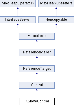

| Class_ID | ClassID () |
|  | Retrieves a constant that uniquely identifies the plugin class.  More...
| SClass_ID | SuperClassID () |
|  | Retrieves a constant representing the type of the plugin.  More...
| virtual IKMasterControl * | GetMaster ()=0 |
| virtual void | SetDOF (int which, BOOL onOff)=0 |
| virtual void | SetInitPos (Point3 pos)=0 |
| virtual void | SetInitRot (Point3 rot)=0 |
| virtual void | MakeEE (BOOL onOff, DWORD which, Point3 pos, Quat rot)=0 |
| CoreExport | Control () |
| virtual | ~Control () |
| virtual BOOL | InheritsParentTransform () |
| CoreExport int | NumRefs () |
|  | Returns the total number of references this ReferenceMaker can hold.  More...
| CoreExport RefTargetHandle | GetReference (int i) |
|  | Returns the 'i-th' reference.  More...
| CoreExport int | NumSubs () |
| CoreExport Animatable * | SubAnim (int i) |
| CoreExport MSTR | SubAnimName (int i) |
| CoreExport void * | GetInterface (ULONG id) |
|  | Inherited from Animatable.  More...
| CoreExport int | PaintFCurves (ParamDimensionBase *dim, HDC hdc, Rect &rcGraph, Rect &rcPaint, float tzoom, int tscroll, float vzoom, int vscroll, DWORD flags) |
| CoreExport int | GetFCurveExtents (ParamDimensionBase *dim, float &min, float &max, DWORD flags) |
|  | This method is called to calculate the largest and smallest values of the anim.  More...
| virtual CoreExport void | BaseClone (ReferenceTarget *from, ReferenceTarget *to, RemapDir &remap) |
| virtual BOOL | PreventNodeDeletion () |
| virtual CoreExport float | EvalVisibility (TimeValue t, View &view, Box3 pbox, Interval &valid) |
| virtual BOOL | VisibleInViewports () |
| virtual BOOL | CanInstanceController () |
| CoreExport void | CloneControl (Control *ctrl, RemapDir &remap) |
| virtual CoreExport SvGraphNodeReference | SvTraverseAnimGraph (IGraphObjectManager *gom, Animatable *object, int id, DWORD flags) |
| virtual CoreExport MSTR | SvGetName (IGraphObjectManager *gom, IGraphNode *gNode, bool isBeingEdited) |
| virtual CoreExport bool | SvHandleDoubleClick (IGraphObjectManager *gom, IGraphNode *gNode) |
| virtual CoreExport bool | SvCanInitiateLink (IGraphObjectManager *gom, IGraphNode *gNode) |
| virtual CoreExport bool | SvCanConcludeLink (IGraphObjectManager *gom, IGraphNode *gNode, IGraphNode *gNodeChild) |
| virtual CoreExport bool | SvLinkChild (IGraphObjectManager *gom, IGraphNode *gNodeThis, IGraphNode *gNodeChild) |
| virtual CoreExport bool | SvEditProperties (IGraphObjectManager *gom, IGraphNode *gNode) |
| virtual void | Copy (Control *from)=0 |
| virtual BOOL | IsReplaceable () |
| virtual void | CommitValue (TimeValue t) |
| virtual void | RestoreValue (TimeValue t) |
| virtual INode * | GetTarget () |
| virtual RefResult | SetTarget (INode *targ) |
| virtual Control * | GetPositionController () |
| virtual Control * | GetRotationController () |
| virtual Control * | GetScaleController () |
| virtual BOOL | SetPositionController (Control *c) |
| virtual BOOL | SetRotationController (Control *c) |
| virtual BOOL | SetScaleController (Control *c) |
| virtual Control * | GetXController () |
| virtual Control * | GetYController () |
| virtual Control * | GetZController () |
| virtual Control * | GetWController () |
| virtual Control * | GetRollController () |
| virtual BOOL | SetRollController (Control *c) |
| virtual DWORD | GetInheritanceFlags () |
| virtual BOOL | SetInheritanceFlags (DWORD f, BOOL keepPos) |
| virtual BOOL | ChangeParents (TimeValue t, const Matrix3 &oldP, const Matrix3 &newP, const Matrix3 &tm) |
| virtual RefResult | PinNodeChanged (RefMessage message, const Interval &changeInt, PartID &partID) |
| virtual BOOL | IsColorController () |
| virtual BOOL | IsLeaf () |
| virtual int | IsKeyable () |
| virtual void | GetValue (TimeValue t, void *val, Interval &valid, GetSetMethod method=CTRL_ABSOLUTE)=0 |
| virtual void | SetValue (TimeValue t, void *val, int commit=1, GetSetMethod method=CTRL_ABSOLUTE)=0 |
| virtual CoreExport bool | GetLocalTMComponents (TimeValue t, TMComponentsArg &cmpts, Matrix3Indirect &parentMatrix) |
| virtual int | GetORT (int type) |
| virtual CoreExport void | SetORT (int ort, int type) |
| virtual CoreExport void | EnableORTs (BOOL enable) |
| CoreExport IOResult | Save (ISave *isave) |
| CoreExport IOResult | Load (ILoad *iload) |
| virtual void | EnumIKParams (IKEnumCallback &callback) |
| virtual BOOL | CompDeriv (TimeValue t, Matrix3 &ptm, IKDeriv &derivs, DWORD flags) |
| virtual float | IncIKParam (TimeValue t, int index, float delta) |
| virtual void | ClearIKParam (Interval iv, int index) |
| virtual void | InitIKJoints (InitJointData *posData, InitJointData *rotData) |
| virtual BOOL | GetIKJoints (InitJointData *posData, InitJointData *rotData) |
| virtual BOOL | GetDOFParams (TimeValue t, Matrix3 &ptm, DOFParams &dofs, BOOL nodeSel) |
| virtual BOOL | CreateLockKey (TimeValue t, int which) |
| virtual void | MirrorIKConstraints (int axis, int which, BOOL pasteMirror=FALSE) |
| virtual BOOL | TerminateIK () |
| virtual void | InitIKJoints2 (InitJointData2 *posData, InitJointData2 *rotData) |
| virtual BOOL | GetIKJoints2 (InitJointData2 *posData, InitJointData2 *rotData) |
| virtual void | NodeIKParamsChanged () |
| virtual void | TMInvalidated () |
| virtual BOOL | OKToBindToNode (INode *node) |
| virtual BOOL | CanCopyIKParams (int which) |
| virtual IKClipObject * | CopyIKParams (int which) |
| virtual BOOL | CanPasteIKParams (IKClipObject *co, int which) |
| virtual void | PasteIKParams (IKClipObject *co, int which) |
| virtual BOOL | CanApplyEaseMultCurves () |
| CoreExport TimeValue | ApplyEase (TimeValue t, Interval &valid) |
| CoreExport void | AppendEaseCurve (Control *cont) |
| CoreExport void | DeleteEaseCurve (int i) |
| CoreExport Control * | GetEaseCurve (int i) |
| CoreExport int | NumEaseCurves () |
| CoreExport float | GetMultVal (TimeValue t, Interval &valid) |
| CoreExport void | AppendMultCurve (Control *cont) |
| CoreExport void | DeleteMultCurve (int i) |
| CoreExport Control * | GetMultCurve (int i) |
| CoreExport int | NumMultCurves () |
| virtual void | PostCloneNode () |
| virtual int | Display (TimeValue t, INode *inode, ViewExp *vpt, int flags) |
| virtual int | HitTest (TimeValue t, INode *inode, int type, int crossing, int flags, IPoint2 *p, ViewExp *vpt) |
| virtual void | GetWorldBoundBox (TimeValue t, INode *inode, ViewExp *vpt, Box3 &box) |
| virtual void | ActivateSubobjSel (int level, XFormModes &modes) |
| virtual void | SelectSubComponent (CtrlHitRecord *hitRec, BOOL selected, BOOL all, BOOL invert=FALSE) |
| virtual void | ClearSelection (int selLevel) |
| virtual int | SubObjectIndex (CtrlHitRecord *hitRec) |
| virtual void | SelectAll (int selLevel) |
| virtual void | InvertSelection (int selLevel) |
| virtual void | GetSubObjectCenters (SubObjAxisCallback *cb, TimeValue t, INode *node) |
| virtual void | GetSubObjectTMs (SubObjAxisCallback *cb, TimeValue t, INode *node) |
| virtual void | SubMove (TimeValue t, Matrix3 &partm, Matrix3 &tmAxis, Point3 &val, BOOL localOrigin=FALSE) |
| virtual void | SubRotate (TimeValue t, Matrix3 &partm, Matrix3 &tmAxis, Quat &val, BOOL localOrigin=FALSE) |
| virtual void | SubScale (TimeValue t, Matrix3 &partm, Matrix3 &tmAxis, Point3 &val, BOOL localOrigin=FALSE) |
| virtual BOOL | RescaleTime (Interval oseg, Interval nseg) |
| virtual int | GetDrawPixelStep () |
| virtual int | GetExtentTimeStep () |
| virtual CoreExport void | GetClassName (MSTR &s) |
|  | Retrieves the (localizable) name of the plugin class.  More...
| virtual BOOL | IsRefTarget () |
|  | Checks if this is a ReferenceTarget.  More...
| CoreExport RefResult | TestForLoop (const Interval &refInterval, RefMakerHandle hmaker) |
|  | Tests for a cyclical reference.  More...
| CoreExport BOOL | HasDependents () |
|  | Checks if a ReferenceTarget has references.  More...
| CoreExport BOOL | HasRealDependents () |
|  | Checks if this has Real (Strong) Dependents.  More...
| void | BeginDependencyTest () |
|  | Starts Dependency Test.  More...
| BOOL | EndDependencyTest () |
|  | Ends Dependency Test.  More...
| virtual void | RefAdded (RefMakerHandle rm) |
|  | Called after a reference is made to a target.  More...
| virtual void | RefAddedUndoRedo (RefMakerHandle rm) |
|  | Called after a reference is made to a target because of undo or redo.  More...
| virtual void | RefDeleted () |
|  | Called after a references to this is deleted.  More...
| virtual void | RefDeletedUndoRedo () |
|  | Called after a references to this is deleted because of undo or redo.  More...
| CoreExport RefResult | DeleteAllRefsToMe () |
|  | Deletes all references to this ReferenceTarget.  More...
| CoreExport RefResult | TransferReferences (RefTargetHandle oldTarget, BOOL delOld=FALSE) |
|  | Transfers all the references from oldTarget to this.  More...
| CoreExport int | DoEnumDependents (DependentEnumProc *dep) |
|  | Begins an enumeration that searches back in the dependency network.  More...
| virtual CoreExport RefTargetHandle | Clone (RemapDir &remap) |
|  | This method is used by 3ds Max to clone an object.  More...
| virtual CoreExport RefResult | NotifyDependents (const Interval &changeInt, PartID partID, RefMessage message, SClass_ID sclass=NOTIFY_ALL, BOOL propagate=TRUE, RefTargetHandle hTarg=NULL, NotifyDependentsOption notifyDependentsOption=REFNOTIFY_ALLOW_OPTIMIZATIONS) |
|  | Notify all dependent RefMakers concerned with the message.  More...
| void | FlagDependents (TimeValue t, PartID which=PART_PUT_IN_FG) |
|  | This sends the REFMSG_FLAGDEPENDENTS message up the pipeline.  More...
| virtual void | NotifyForeground (TimeValue t) |
|  | This method is called to flag dependents into the FG.  More...
| virtual void | NotifyTarget (int message, ReferenceMaker *hMaker) |
|  | Sends messages to ReferenceTargets.  More...
| virtual CoreExport BaseInterface * | GetInterface (Interface_ID id) |
| CoreExport | ReferenceTarget () |
|  | Constructor.  More...
| virtual CoreExport RefResult | AutoDelete () |
|  | Deletes the object when it has no more real dependents.  More...
| CoreExport RefResult | MaybeAutoDelete () |
| CoreExport RefResult | ReplaceReference (int which, RefTargetHandle newtarg, BOOL delOld=TRUE) |
|  | Used when cloning reference makers.  More...
| CoreExport RefResult | DeleteAllRefsFromMe () |
|  | Deletes all references from this ReferenceMaker.  More...
| CoreExport RefResult | DeleteAllRefs () |
|  | Deletes all references both to and from this item.  More...
| CoreExport RefResult | DeleteReference (int i) |
|  | Deletes the specified reference.  More...
| virtual BOOL | CanTransferReference (int i) |
|  | Tells whether this reference can be transfered.  More...
| CoreExport ReferenceSaveManager & | GetReferenceSaveManager () |
|  | Access the ReferenceSaveManager of this ReferenceMaker.  More...
| virtual int | RemapRefOnLoad (int iref) |
