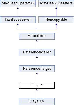

| virtual SClass_ID | SuperClassID () |
|  | Retrieves a constant representing the type of the plugin.  More...
