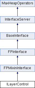

+ Inheritance diagram for ILayerControl:
