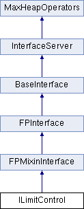

+ Inheritance diagram for ILimitControl:
