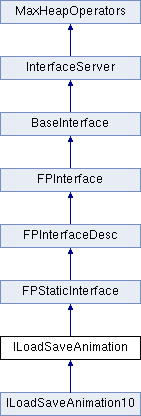

 Inheritance diagram for ILoadSaveAnimation:
 Inheritance diagram for ILoadSaveAnimation:| Public Member Functions | |
