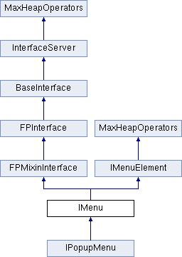

+ Inheritance diagram for IMenu:

- Public Types inherited from BaseInterface
enum  LifetimeType { noRelease, immediateRelease, wantsRelease, serverControlled }
- Public Types inherited from IMenuElement
enum  OriginLocation { UPPER_LEFT, LOWER_LEFT, LOWER_RIGHT, UPPER_RIGHT }
